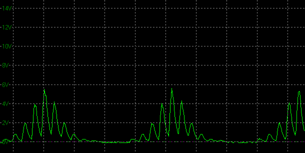

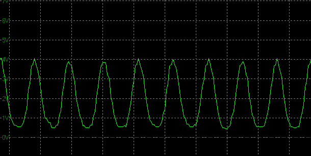

We got some more oscillographs from TFTCentral article/review!
I measured all the pulse widths mid-height. They're mostly the same as Monitors Unboxed. But I should note that the measured widths don't necessarily correspond to perceived average MPRT. I haven't seen anyone confirm they do. Not sure if the graphs need to be gamma corrected for this method to work. However, all the ufos of Pulsar at 360 fps I saw online do correspond more to ~40% rather than 25% (~2 vs 1.25 pixels of blur at 1800 pps, assuming camera tracking is accurate).
Pulsar @360 Hz:
- 360 fps = ~1.1 ms
- 250 fps = ~1.3 ms
- 200 fps = ~1.5 ms
- 150 fps = ~1.9 ms
- 127 fps = ~2.3 ms
- 100 fps = ~2.6 ms
Graph X-axis scale = 2.5 ms
Pulsar @360 Hz at various settled frame rates:

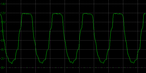

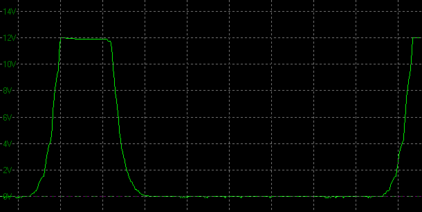

We also got new ULMB 2 graphs (thank you Simon for providing these).
The same note from comment above regarding mid-height measurements applies here. Also keep in mind that graphs are not the most accurate due to smoothing effect. Standard square pulses that normally look like this, look like this. I'm guessing they actually look closer to this (DyAc 2 Premium @540Hz).
Observations:
- When I plot the measurements into one of my MPRT charts, the 360-120Hz range scales somewhat linearly in terms of MPRT target, but the 60 Hz mode goes off-track with lower duty cycles.
- ULMB MPRT target at PW 50 is very similar to Pulsar MPRT target.
- ULMB pulsing is more stepped, while Pulsar has a smooth sinusoidal wave.
- Some multi-strobing might be spotable at lower duty cycles for 360-120 Hz range. 60 Hz doesn't show signs of this.
- PW differences at higher refresh rates are rather minor, but become larger at lower ones. PW 100 vs 10 at 360 Hz is ~0.5 ms difference, at 240 Hz ~1 ms, at 120 Hz ~2 ms, at 60 Hz ~4 ms.
ULMB 2 @360 Hz fps:
- PW 100 = ~1.5, 1.4 ms
- PW 50 = ~1.0, 1.1, 1.2 ms
- PW 10 = ~1.0 ms
ULMB 2 @240 Hz fps:
- PW 100 = ~2.1 ms
- PW 50 = ~1.5, 1.6 ms
- PW 10 = ~1.1 ms
ULMB 2 @120 Hz fps:
- PW 100 = ~3.7 ms
- PW 50 = ~2.4 ms
- PW 10 = ~1.6 ms
ULMB 2 @60 Hz fps:
- PW 100 = ~5.9, 4.7 ms
- PW 50 = ~2.4, 3.1 ms
- PW 10 = ~0.8, 0.7 ms
Graph X-axis scale = 2 ms
